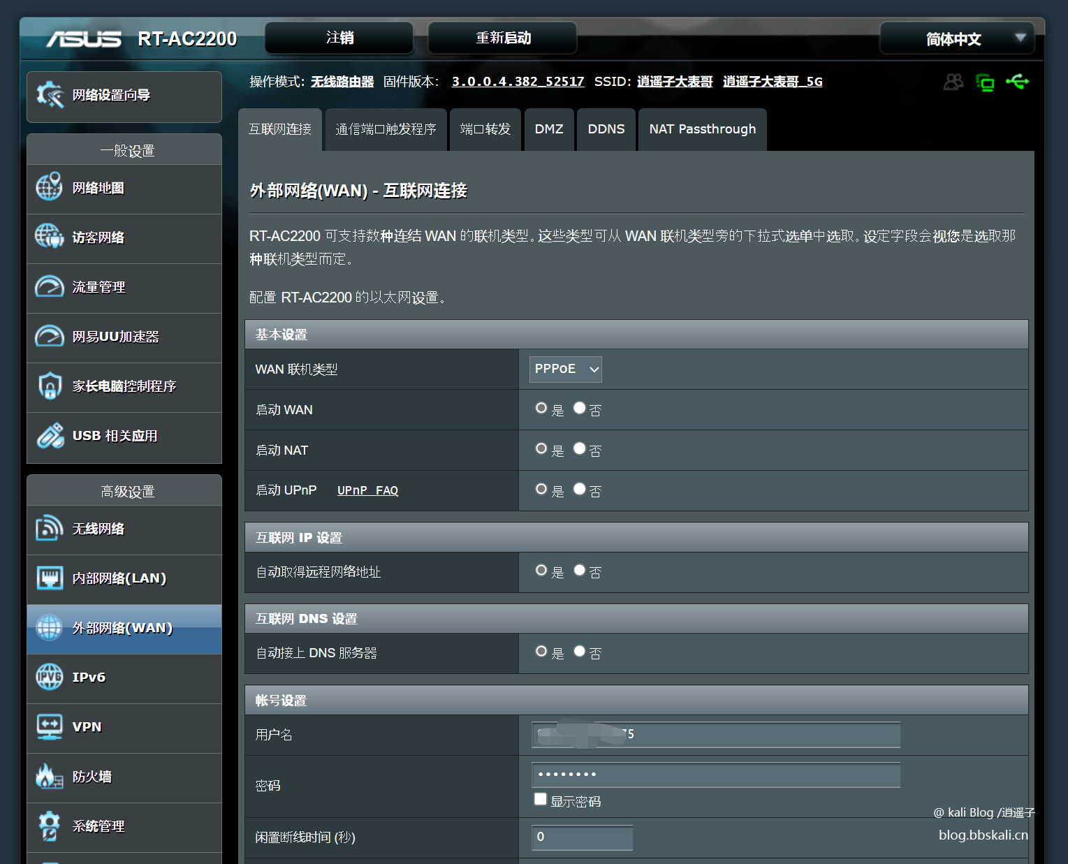

First use the super administrator password to log in to the optical cat, and set the network mode to bridge mode 设置上网方式为桥接模式
Then, log in to the router and set the Internet access method to pppoe. Configure an Internet account and ensure that you can access the Internet normally.u1u4jjwylkz2012.png Configure ipv6. When saving normal Internet access, click the ipv6 tab on the left. Set the Internet access method to Native.
